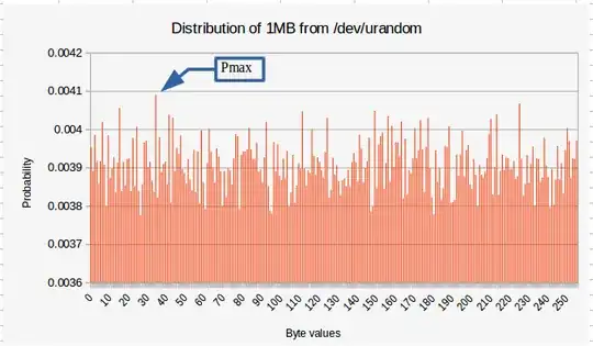

As a picture, this is a histogram of 1MB of really random data:-
histrogram
We can assume that this is unbiased. Yet there is significant variation in the individual byte probabilities (the random thing). Ergo there must be a max probability. This leads to a min entropy value of 7.93 bits /byte. So for an output of 1MB, you can only count on 992000 bytes of entropy for cryptographic purposes. That's 0.9% less than you might naively expect. Incidentally the chi for this gives p = 0.15.
