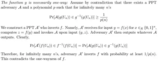

Consider the function $g$ defined by $g(x) = f(x) \mathbin\| f(f(x))$. It is easy to prove that $g$ is a OWF as well, assuming that $f$ is length preserving (that is, $|f(x)|=|x|$ for all $x$). Here's a sample proof, taken from Lindell's final exam:
Lindell's proof
Now consider the case where $f$ is a general OWF, not necessarily length preserving. This case is considered in Katz & Lindell book, 2nd Edition, Exercise 7.8:
Exercise 7.8
Q: Why Lindell's proof for length-preserving $f$ does not work?
A: In the proof mentioned above, $\mathcal{A}'$ invokes $\mathcal{A}$ on $y || f(y)$, which upon success, returns $x'$ such that $f(x') \mathbin\| f(f(x')) = y \mathbin\| f(y)$. However, this does not entail $f(x') = y$, as the length of $f(x')$ might be different from the length of $y$.
