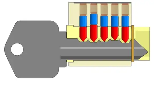

Attacker can't simply pick bits one by one. It's like lock and key: Lock
You can't simply open one pin and know if you are right. Lock will only rotate if all pins are correct. Otherwise it won't rotate. So while lock with one pin is as easy as trying that one pin, lock with two pins you already don't know which pin is wrongly set. Same happens with cryptography. One bit encryption doesn't let you see how it scales (so you assumed linear growth - wrong). It's not that you can pick each bit at once. You need to crack all at once. And somewhat like with lockpicking, cryptographic algorithm is broken when you find that some pins actually give you some hints as to what state of "lock" is.
