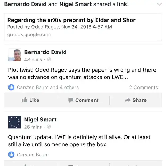

As mentioned in the comments, there is a serious flaw in the paper, and it has been withdrawn: see https://groups.google.com/forum/#!msg/cryptanalytic-algorithms/WNMuTfJuSRc/OtQMLRXgBwAJ and part (3) of http://www.scottaaronson.com/blog/?p=2996

So, current schemes for encryption etc. are not affected per se. Furthermore, the authors believe that this is a fundamentally different problem. However, it is quite likely that this result will cause a flurry of research to see if it can be extended.
An update on this; it appears that all may be fine with LWE!
