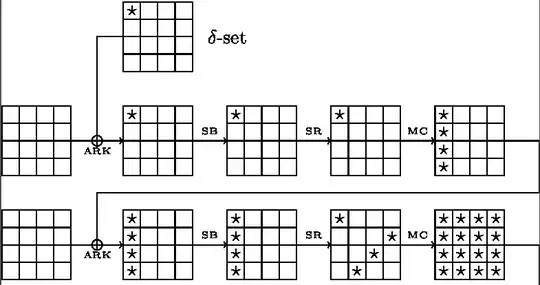

In order to assert the diffusion of a block cipher you need to show that every bit of the output depends on every bits of the input. This can be done by hand when the block cipher is not too complex.
A simple case: AES
AES you can see that a difference in a word will be propagated into the full block after 2 rounds (look at the $\star$).
This proves the word diffusion, now you need to prove that the S-box is actually safe. In other word show that any bits in the input have an influence on any bits in the output of the S-box (testing for differentials cryptanalysis is one of the way to do it).
