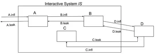

  1. Is the composition of clocked entities a clocked entity? The authors claim that this is trivially true and does not require a proof, however, I'm not convinced with this claim. I have constructed the following counter example for the same:
    • Consider an interactive system $\mathcal{IS}$ composed of three clocked entities A, B and C. Further, consider a clocked entity D outside the system $\mathcal{IS}$. Let say the activation token enters the interactive system $\mathcal{IS}$ at port A.infl. Further A calls B, which in turn calls D. At this stage, A, B and $IS$ are in the calling state by definition. Now let say D calls C, which is currently inactive, hence C is activated now. But if $\mathcal{IS}$ was a clocked entity in the calling state, it should have bounced back the activation token when it receives activation token on any port other than D.leak. Hence $\mathcal{IS}$ does not follow the satisfy all the requirements of a clocked entity. The counter example

When you compose $2$ interactive systems $\mathcal{IS}_1$ and $\mathcal{IS}_2$ into $\mathcal{IS}_1 \circ \mathcal{IS}_2$, the book indicates that you're simply connecting the matching ports between them.
In your example $\mathcal{IS} \circ D$ is a clocked entity because when $B$ calls $D$ then $D$ makes a recursive call to $\mathcal{IS}$ by sending the token to $C$. Taking from the book: "When it is clocked it must eventually return the activation on the matching outport leak" not immediately.
