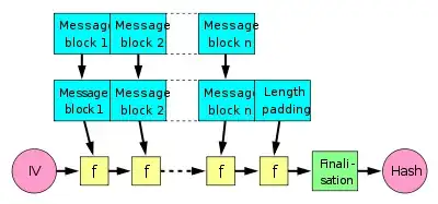

They are all hash functions. Apart from that, they are structurally quite different. The SHA family (SHA-0, SHA-1, and the SHA-2 functions such as SHA-256 and SHA-512) use the Merkle-Damgård construction, around an internal permutation which happens to be an extended Feistel network. Low-level primitives include boolean bitwise operations, and addition over 32-bit or 64-bit integers.

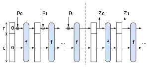

In SHA3, the structure is that of a sponge function, which is quite different. Moreover, the inner permutation is not a Feistel network; low-level primitives are boolean bitwise operations over 64-bit words, but not additions. This avoidance of operations that involve carry propagation helps a lot with performance on hardware implementations (FPGA, ASIC).

The difference is: All SHA-0, 1 & 2 and MD5 come under a class of algorithm called Merkle–Damgård construction, while SHA-3 falls under Sponge functions.
Merkle–Damgård construction is a method of building collision-resistant cryptographic hash functions from collision-resistant one-way compression functions. Merkle–Damgård construction
And, Sponge functions are a class of algorithms with finite internal state that take an input bit stream of any length and produce an output bit stream of any desired length.
Sponge Function
