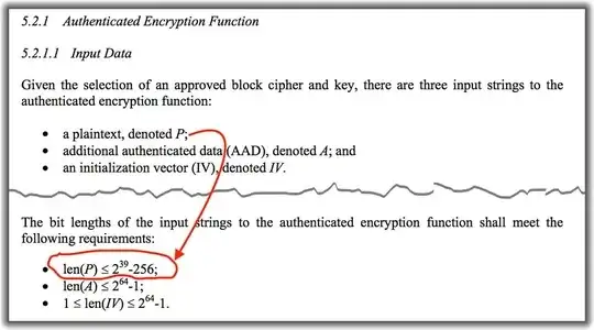

Based on NIST SP 800-38D section 5.2.1.1, it seems that the maximum length of plaintext is 2^39-256 bits ~ 64 GB.
Screenshot of the spec
We've got 100+GB files in genomics that need to be GCM encrypted so are concerned about hitting this.
So two questions:
  • What's the source of this rather low limitation?
  • What happens (mathematically, not implementation wise) if you do cross this limit?
