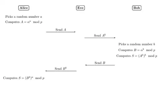

I am trying to understand the small subgroup confinement attack on the Diffie-Hellman algorithm. I will present the attack and try to explain why it works.
Small subgroup confinement attack on the Diffie-Hellman algorithm
Let $\mathbb{Z}_p^*$ be a group, where $p$ is a large prime and let $\alpha$ be a primitive root modulo $p$. Let's consider that Alice and Bob want to do a key agreement on the whole cyclic group $\mathbb{Z}^*_p$ using the Diffie-Hellman algorithm. The following sequence diagram illustrates how Eve can perform a small subgroup confinement attack:
Small subgroup attack on Diffie-Hellman key-exchange
By doing this, if $k$ is well-chosen, the secret $S$ can be found by exhaustive search.

Could someone approve or disapprove my demo?

The proof provided in the question is correct, but as Chris Peikert pointed out in comments, there is an easier way to prove that $S \in \mathbb{G}_w$:
$ord(\alpha^k) = \frac{ord(\alpha)}{ord(\alpha) \wedge k} = \frac{p - 1}{(p-1) \wedge k} = \frac{p - 1}{k} = w$ so it implies that $\alpha^k \in \mathbb{G}_w$.
As $A^k = (\alpha^a)^k = (\alpha^k)^a$ is a power of $\alpha^k$, it also implies that $A^k \in \mathbb{G}_w$.
In the same way, $S$ is a power of $A^k$ so $S \in \mathbb{G}_w$.
