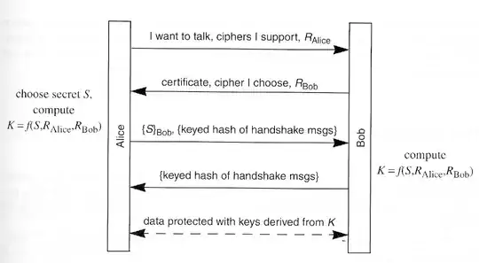

Simplified SSLv3/TLS Simplified SSLv3/TLS from this book Note, $R_{(Alice|Bob)}$ is a random nonce chosen by Alice or Bob respectively, and $\{S\}_{Bob}$ is encryption with Bob's public key.
pre-master secret
As stated in one of the answer you link to, "The point of a premaster secret is to provide greater consistency between TLS cipher suites."
In the figure above, the premaster secret is $S$ (in message 3). In this case, it is randomly generated. It could come from a diffie-hellman exchange, or some other method, depending on the agreed upon cipher suite.
It isn't really "related to the private keys" but how it is generated/agreed upon depends on the cipher suite chosen in the second message of the figure.
master secret
In the figure above, the master secret is $K$. Shown on the sides, it is a function of the pre-master secret and the two random values sent in the first two messages.
private key
I'm not really sure where this comes from. It could refer to the Bob's private key for the certificate sent in message 2. It could also refer to private keys used in a diffie-hellman key exchange. If doing client authentication, it could refer to the client's private key associated with their certificate.
shared secret / session key
This is what is referred to in the last step of the figure. The session key is referred to as "keys derived from K". Many keys are actually derived from K. This could be the encryption key, integrity protection keys (for say HMAC), IVs for the ciphers, etc. And, it is usually a different set for each direction.
