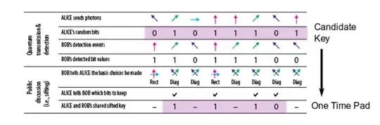

Your question is now 4 1/2 years old, and things have moved on for pad distribution (at least in the professional arena). Hobbyists are still stuck with pigeons and USB drives secreted about their bodies, having clandestine meetings and physically exchanging bits.
Professionally, there are an ever increasing number of quantum key distribution networks (QKDNs) which send the OTP material via laser beams. In essence it happens like the following, with ALICE beaming her true random bits from her TRNG (typically a beam splitter) to BOB:-
After some processing and validation, BOB and ALICE are both in possession of key material suitable for OTP use. VoilĂ .
And as for "how do I make sure no one else gets these keys?" It doesn't matter. The distribution of the photonic based keys is governed by the Observer effect which means that in an ideal QKDN, if nasty EVE reads the photons, ALICE/BOB will be able to tell as their polarisations will have changed. They then invalidate that particular key transmission and redistribute. There are more nuances to QKDNs than punched paper tape distribution used to have, but essentially the focus of trust shifts from the courier to the QKDN provider.
Image is an extract from a longer answer...
