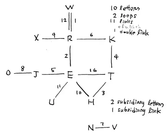

Using this as a crib, the menu that this produces has three loops (REHTK, EHT, RETK) and a click (loop of the two letters WR), which is pretty good as a crib as this means that the bombe then returns far fewer false stops.

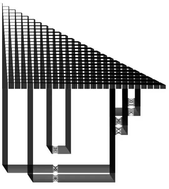

After a year I have managed to find a suitable solution to the problem. My understanding is based on the following picture that I created, based on a simplified version that I found online (at present I cannot find the reference, if I do I will edit it in).
It is supposed to be a bombe and can be understood in two parts.
  • The top contains 26 columns, one per letter of the alphabet. Each column is made of 26 connections one from each letter to each other. That what gives the triangular effect.
  • The bottom half are what would be the bombe connections depending on the menu derived from the crib. Each block that we can see spans and connects two columns are based on the crib and the corresponding position of the rotors.
The idea is that in the real bombe all these lines are wires and a current is introduced arbitrarily somewhere. Then the current flows through the diagram making lines 'live' and others not.
A live connection between two letters means that either there is a Steckerverbindung between them else they are not Steckered together. Although this sounds like a tautology, we do need to consider the picture as a whole. For example: if at the A column only the F connection is live, then it means that it is consistent that A and F are Steckered together; if at the A column more both F and G are live, then it means that A is not Steckered with either F or G; if at the A column all connections are live, then this means we have a definite contradiction, and that means the bombe position is false - and in such a case the bombe, I assume, would have just continued.

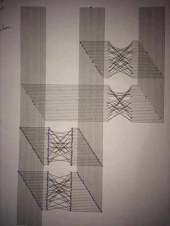

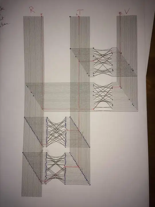

We can test the information above with such a diagram as above. The following diagrams are all close ups of the diagram above (the top right part of the bottom half):
  1. The bombe is in the correct position and the current is sent into a correct connection, as in the picture below.enter image description here Here the current is sent to the X connection in the R column. I indicated in red the live current. It flows through the diagram and as can be seen. Eventually we see that the L wire of the T column s live, as is the E wire of the V column. Nothing else in this block becomes live. So it is consistent that we have the three Steckerverbinugen RX, TL and VE.
  2. The bombe is in the correct position and the current is sent into a false connection. Again we can use the picture above but now we concentrate on the blue. Here I assumed the current was sent in at the A wire of the T column. In this case eventually every wire is live except the correct wires as given above (at least in the given part of the picture). When I say eventually, this means that one has to follow in and out of all the connections, and up through the top part of the diagram when necessary. Hence when the bombe is in a correct position and viewing the diagram as a graph, we would have (ideally) two connected components: the correct component (where there is at most one live wire per column) and the false component (where we would have at least one non-live wire pre column). I say ideally since there would be at least one extra component of information that is unobtainable from the rest (i.e. letters that are not part of the steckers we can find and don't appear in the crib).
  3. If the bombe is in a false position, then it shouldn't matter we the current is sent in. I did this in the following diagram, which is the same as the original but all rotors have been shifted by one position.enter image description here Here the current enters at the L wire of the T column. In this case, eventually, everything becomes live, which gives the contradiction.
We also learn from this set up the importance of the loops in the crib. This enables a lot of feedback, which is particularly important when the current is sent into the false wire.
Hence to answer my original question: when did the bombe stop? It seems that it should not stop when one column is completely live. And therefore perhaps it stopped when there was at least one non-live wire per column. If your crib had no loops, and therefore no feedback, then this condition would be easily satisfied, and there would be far too many bombe stops to deal with.

Menu
Ciphertext $\tt RRHKJ \ KNJXE \ UWNFO \ T$ has 16 characters. Crib $\tt WETTE \ RVORH \ ERSAG \ E$ has 16 characters too. Align crib to ciphertext at position 1 and there is no clash.
          1     1 1
1   5     0     5 6
RRHKJ KNJXE UWNFO T <- ciphertext
WETTE RVORH ERSAG E <- crib
Assume turnover (t/o) position is at 13, 14, 15 or 16. We use letters at positions 1-12 and 16 to build a menu. It has 10 letters, 2 loops, 11 links of which one is a double link. There are two subsidiary letters and one subsidiary link.
Wetter menu positions 1-12, 16
