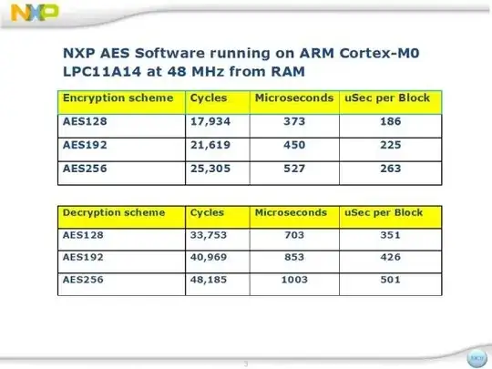

UPDATED: The following slide deck has good info on state of the art lightweight block ciphers vs. legacy (along with source code links). Considers code size, RAM, and cycles/byte metrics for many algorthims).
