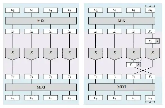

I read about the AEZ encryption scheme as presented at the CAESAR competition. To me it seems like a construction of an arbitrary length block cipher from a smaller one. The key component is the mixing function. (See the figure… Left: without cipher text stealing, Right: with cipher text stealing.)
Mixing
Image source: http://www.cs.ucdavis.edu/~rogaway/aez/aez.pdf
The construction is only used in the v1.x of AEZ, because it requires appriximately 1.8 AES calls per block of plaintext, while the one used in v2.0 requires only 1 AES per block asymptotically. It is originally due to Naor and Reingold.
It is more like a block cipher mode than a way to construct a larger block size cipher from a smaller one. Specifically, it does not improve the birthday bound which limits the number of blocks encrypted to less than the square root of block size (i.e. $2^{64}$ for AES).
In my opinion the properties of a mixing function would be:
The requirements for the mixing function are given in the paper above. It is enough that the functions MIX and MIXI are pairwise independent permutations, but that is not a strict requirement. Instead it is enough that they are $\epsilon$-AXU2: $\forall x \not = y, z \in \{0,1\}^n: P[f(x) \oplus f(y) = z] \le \epsilon$.
The paper NR mode of operation (ps) refers to several types of functions that fit the bill if you are interested in using something else.
