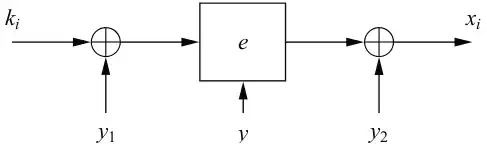

While it may be confusing, that Wikipedia article is actually correct! Let me try to explain it a bit better…
Definition of key whitening
Key whitening is an extremely simple technique to make block ciphers like DES much more resistant against brute-force attacks. Like you’ve already discovered yourself, this is the basic scheme:
block cipher – basic scheme of key whitening
Or, defining it a bit more mathematically…
Encryption: $y = e_k,k_1 ,k_2 (x) = e_k (x \oplus k_1 ) \oplus k_2$
Decryption: $x = e_k^{-1},k_1 ,k_2 (x) = e_k^{-1} (y \oplus k_2 ) \oplus k_1$
In addition to the regular cipher key $k$, two whitening keys $k_1$ and $k_2$ are used to $\oplus$ (XOR-mask) the plaintext and ciphertext.

A prime example of such a cipher would be DES. A variant of DES which uses key whitening is DES-X. In the case of DES-X, the $k_2$ is derived from $k$ and $k_1$.

One way key whitening improves security is by increasing resistance to bruteforce attacks (and doing this essentially for free). Consider, for example, DES. Key is 56 bits, so given a single pair $(M, E=DES(K,M))$ attacker will find $K$ in $2^{55}$ operations on average.
By employing key whitening it is possible to increase required effort substantially: we extend key by 128 bits (2 times block size) and use those additional key bits to mask (whiten) plaintext and ciphertext. This scheme is essentially DES-X: $DES\unicode{x2d}X(K, M) = K_3 \oplus DES(K_1, K_2 \oplus M)$ where $K$ is a concatenation of $K_1$, $K_2$, and $K_3$ and $\oplus$ is XOR.
Now, if attacker gets a pair $(M, E=DES\unicode{x2d}X(K, M))$ he will have to brute-force $2^{183}$ operations on average (and the legitimate encryption/decryption only costs two extra XORs).
Note that whitening is part of the encryption algorithm itself and thus it's assumed that attacker cannot observe input after whitening or output before whitening (in this case whitening keys are trivially recovered).
Edit: As @otus pointed out, the security bound for $DES\unicode{x2d}X$ quoted in this paper is $2^{118-lg(m)}$.
Edit: It seems the confusion behind "Key Whitening" is caused, at least partially, by the imprecise title of the Wikipedia article. What it describes is effectively a data whitening, not key whitening. @otus pointed out in comments that this might be due to Rogaway using terms "pre-whitening key" and "post-whitening" key in his work (link above), which sounds plausible to me. Section in Bruce Schneier's "Applied Cryptography" describing this concept is simply called "Whitening".
