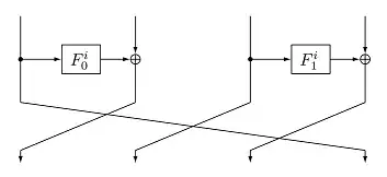

Blowfish is a 64-bit block cipher based on a Feistel structure with a 32-bit F function. This can be extended to a 4 branch design to operate on a 128-bit block quite easily. There would need to be a slight change to the key schedule to distribute the round keys properly, either by performing the key expansion twice on each key half, or by producing more round subkeys. CLEFIA is another block cipher with a 32-bit F function and a 4 branch design, and has been shown to be secure in practice.
4-branch Feistel structure
