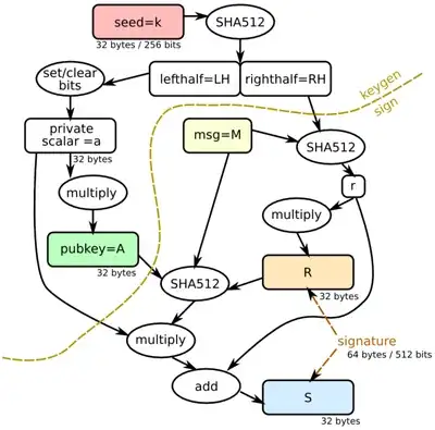

The following python code uses the NACL library to generate signatures. Additionally the ECPy library is used to implement EC calculations concisely. You can use NACL._sodium.(whatever) but that's a lot more verbose. AFAIK this should just work securely assuming you have an ED25519 signature. Vanilla Schnorr signatures require slight changes to a few sections.
The following graphical overview of the ED25519 signature system is useful for understanding the code below.
