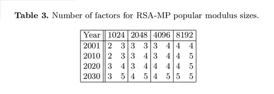

  • Table 3 of the paper Unbelievable Security: Matching AES security using public key systems also addresses this issue. It suggests that, for a 2048-bit modulus, $k=3$ primes offers no measurable loss of security. Starting in 2030, $k=4$ primes will offer no loss in security (it changes over time because NFS factoring speeds up faster than ECM factoring). Here is Table 3:
    table 3 from Lenstra's paper
