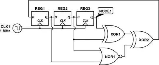

Update per comment: We can implement a circuit that outputs a de Bruijn Sequence of length $2^n$ using $n$ D-type flip-flops connected as for a maximal-length Fibonacci LFSR with $n$ stages, by adding an additional XOR term equal to the NOR of the outputs of the $n-1$ flip-flops on the feedback's side. In the following drawing (which outputs the example sequence above), the added gates are NOR1 and XOR2.
schematic
Note 0: When the number of stages $n$ gets large, the NOR gate with $n-1$ inputs gets annoying; one can trade this for a $\lceil\log_2(n)\rceil$-bit counter with reset, counting the number of consecutive zeroes in the output, giving a $1$ when reaching $n-1$ consecutive zeroes, and that output the additional XOR term.
