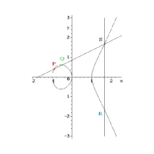

It seems even less intuitive when just looking at the bubble vs curve as here: enter image description here
Since there are other curves (let's say anything from a sin wave to the $x^3 + x$ or even just some unusually shaped contour) that could do the job. It seems like they would provide much more surface area to get a larger space in $\mathbb{Z}_p$ or really just more possible combinations of connecting lines from some arbitrary $P$ and $Q$ to get $R$ as opposed to something as restrictive (on the graph) as beginning from some bubble (which would seem to unnecessarily reduce the possible combinations) and then use a modulus to implement the discrete logarithm problem.

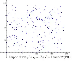

So it seems like this is the version of elliptic curves over a finite field:
Yes that looks pretty random. But I'm still not really seeing why they are the only equations that have cryptographic significance. It's difficult to imagine that if you simply took some other higher degree equation and applied modulus (to place within a group), then it seems like it would make sense that you'd get something that's also comparatively random.

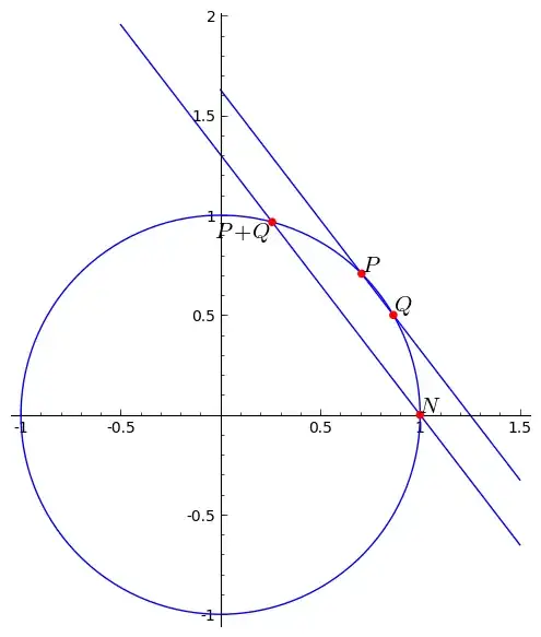

For example, conic sections (quadratic equations) do have a well-defined geometric addition law: given $P$ and $Q$, trace a line through them, and trace a parallel line that goes through the identity element. Here's a handy picture for one of the best known conics, the unit circle $x^2 + y^2 = 1$:
If you take the identity element to be $(1, 0)$, then you get the very simple addition formula (modulo your favorite prime)
$$ (x_3, y_3) = (x_1x_2 - y_1y_2, x_1y_2 + x_2y_1)$$
This is much faster than regular elliptic curve formulas, so why not use this? Well, the problem with conics is that the discrete logarithm in this group is no stronger than the discrete logarithm over the underlying field! So we would need very large keys, like prime-field discrete logarithms, without any advantage. That's not good.
