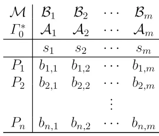

Ok, let us take additive perfect secret sharing over a prime field $Z_p$, i.e., the secret $k$ is represented $k=\sum_{i=1}^m s_i \pmod p$ for random $s_i$.
Then we can come up with the following matrix, where we have $b_{i,j}=1$ if $P_i\in {\cal A_j}$ and $b_{i,j}=0$ otherwise. enter image description here
Now, we can distribute the shares $s_1,\ldots,s_m$ in the following way. Every user $P_i$ obtains the set of shares $S_i=\{s_j: b_{i,j}=1\}$ (i.e., a participant obtains a share if he shows up in the respective set of the dual basis or equivalently, obtains no share if he shows up in the respective set of the maximal unauthorized subsets).
I will not come up with an explicit example anymore today. But this secret sharing enables every authorized subset in $\Gamma$ to reconstruct the secret $k$ and any non-authorized set will not be able to do so.
