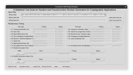

I have no experience and no knoweldge on how can that be possible, but ClaudeAI figured out it has to be a pseudorandom number generator (pRNG), with a seed that its known by both, the machine and the cartridge. I can't get that seed, because there is no way that I can read the program that is running on the machine/cartridge (it's a hardware impossibility by design), nor its memory. I also have some proofs that the communication uses a pRNG, thanks to this github project, which gave me these results: Output of NIST Test Suite when using what the machine sent to the cartridge in all the 420 init commands. I have no idea on how to interpret all those numbers (I only had a basic probability and statistics course), but the "Non-Random" results makes me think its a pRNG.
