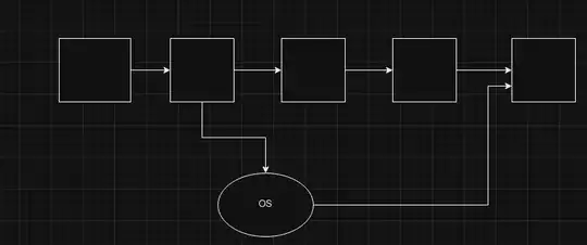

From what I understood from this paper is that we can construct a circuit, which does (at most) n search steps. Say we build this circuit as in the picture below, where each block is a step through a search tree (specifically for the mentioned SAT paper, each block is a so-called 'giant step'). In each block we may have to backtrack in the tree, so we need as additional input the oblivious stack for pop and/or push operations.
flowgraph
Is my construction of using OS correctly described in the picture? So is the OS simply an external datastructure which holds garbled values as depicted in the image? Independent of the answer to that question, I would like a reference/code sample which helps me understand how this is done on the code level (The source code for the OS of the code repository of the linked SAT solver are unintelligible, also the EMP framework is not documented at all).
