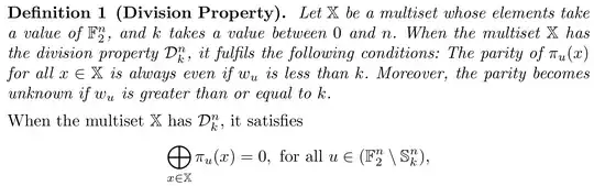

enter image description hereDivision property is proposed as a generalized integral property at Eurocrypt 2015 by Yosuke Todo in his paper Structural evaluation by generalized integral property, And in paper Integral Cryptanalysis on Full MISTY1.
It says " linear operation $\mathsf{XOR}$ does not affect the division property", which means if every element in the input multiset is $\mathsf{XOR}$ed with a constant (or a key), the Division Property of the output multiset will be the same with the Division Property of the input multiset.

Let us first review the notations. For any $x, u \in \mathbb{F}_2^n$,
$$\pi_u(x) = \prod_{i=1}^n x[i]^{u[i]}$$
where $x[i]^1 = x[i]$ and $x[i]^0 = 1$. Equivalently, we can write
$$\pi_u(x) = \prod_{j\,s.t.\,u[j]=1} x[j]$$
The hamming weight of an element $x$ is denoted by $w_x$, i.e., $w_x = \sum_{i=1}^n x[i]$. Also, the set $S_k^n = \{x \in \mathbb{F}_2^n \,|\, w_x \geq k\}$ is the set of all elements with hamming weight greater than equal to $k$. Now, a multiset $\mathbb{X}$ has $D_{k}^n$ property if $$\bigoplus_{x \in \mathbb{X}} \pi_u(x) = 0, \forall u \in (\mathbb{F}_2^n \setminus S_k^n)$$
i.e., the parity of $\pi_u(x)$ for all $x \in \mathbb{X}$ is even when $w_u < k$. Let us analyse the division property of the multiset $\mathbb{Y}$ obtained when the element $e_1 \in \mathbb{F}_2^n$ (the binary string with 1 in the first bit and 0 in the remaining) is $\mathsf{XOR}$ed to the multiset $\mathbb{X}$, i.e., $\mathbb{Y} = \{x \oplus e_1 \,|\, \forall x \in \mathbb{X}\}$. Let $u \in \mathbb{F}_2^n$ such that $1 \leq w_u <k$. Consider the case where $u[1] = 1$, then
