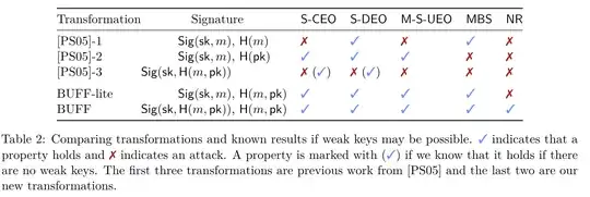

Cremers et al. introduced a (collection of) security notions titled Beyond UnForgeability Features (BUFF). This captures Unforgeability, Malicious Stronger, MBS (collision resistance), and Non-assignability (NS). NS captures the inability to sign a message the adversary does not “know.” There are two generic transformations proposed $(\text{Sign}(sk, m), H(pk,m))$ and $(\text{Sign}(sk, H(pk,m)), H(pk,m))$.

On signature size: Both generic transforms inevitably increase signature size. However, for a specific scheme, the simpler transformation of Pornin and Stern, a.k.a PS-3, is shown to be enough to achieve BUFF security without increasing signature size. PS-3 is defined as $(\text{Sign}(sk, H(pk,m))$

Specifically for MBS security, the PS-1 transform provides MBS security (Collision resistance) under collision resistance of the hash function. PS-1 is defined as $(\text{Sign}(sk, n), H(m))$. However, the signature size must increase.
The picture below (from Cremers et al.) recaps the various constructions and their security.
