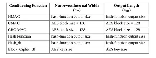

Practically and somewhat circuitously, we can go with NIST's recommendations. They posit that "full entropy" is that where a sample's $\epsilon \le 2^{-64}$.
They also state that the following table of functions is acceptable in generating full entropy from an input:-
table
There's a managerie of hashes and ciphers. We can assume that your $\mathbb{Z}_2^{l \times n}$ and even Toeplitz matrices would be included as those are currently used in commercial TRNGs calibrated with the same Left Over Hash lemma.
So my answer in short is that yes, it appears empirically, commercially and standards wise that the lemma holds for all types of decent (but not necessarily even cryptographic) hash.
