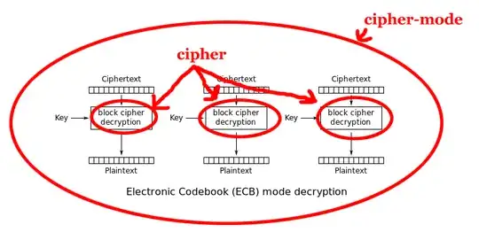

Last but not least, here are two examples I've quickly wrapped up to show you where exactly the "cipher" plays a role, and where the "cipher-mode" comes in:
ECB
(The default, classic mode of encryption/decryption; but not really recommended due to potential security issues.)
ECB example

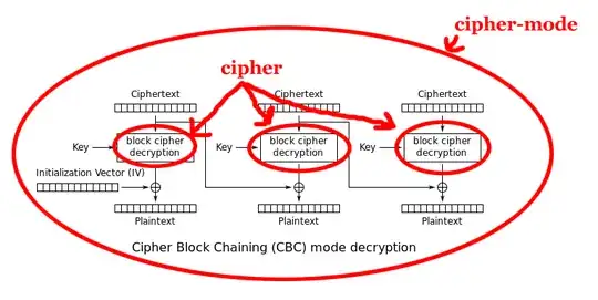

CBC
(One of many cipher-mode options that - compared to ECB - represents a safer encryption/decryption mode.)
CBC example
