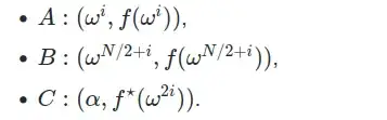

Now I computed f*(w^2i) i = 0 to 7 using formula depicted in below figure with alpha = 13 and I got [ 12, 11, 16, 1, 11, 13, 12, 9 ].
This is one round of FRI protocol. In all the computations, I used mod 17. I hope I computed all these values correctly. If some value is incorrect, please correct as per the protocol.
Now during verification, I choose value of i = 3 from verifier. I got 3 points A( 3, 7 ) , B( 14, 14 ), C( 13, 12 ).

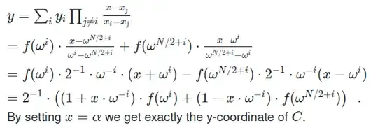

When I do Lagrange interpolation using formula in below figure, I get L(alpha) = 1 but y-coordinate of C is 12 which shows verification fails.
I am not able to understand where I have gone wrong. Please correct me and give me a case where verification passes successfully. Atleast, please explain a small example where verification becomes successful.
