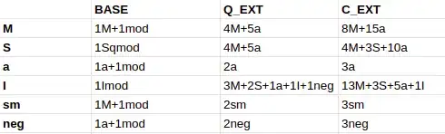

Field Operations
The following is the table of how many operations in the underlying field each top-level operation costs, with the usual notation: M=multiplication, S=squaring, a=addition, I=inversion, sm=scalar/constant integer multiplication, neg=negation. In the case of the BASE, which is the base field $F_p$ without any extension, the costs described are in terms of the operations using the gmp library, so M=mpz_mul, Sqmod=mpz_powm_ui, a=mpz_add, mod=mpz_mod, Imod=mpz_invert.
So for example a multiplication in a cubic extension of a field needs 8 multiplications and 15 additions of the underlying field it is extending, and so on. Most if not all of these come from the book Guide to Pairing Based Cryptography.
Computational cost of basic operations
This is somewhat difficult to calculate because it is hardware dependent and variable within the same HW as well. It is also dependent on the prime number of the field. For all the measurements here I used the prime field of the curve BN128. I measured the time each basic gmp operation took and compared it to the addition operation by averaging over a big number of repetitions. These are the approximate results on my HW (everything in units of addition):
As you can see, for the base field at least, the cost of an inversion is not at all 100x that of a multiplication, but rather 10x. If we consider the fact that I perform a modulo operation after each mpz multiplication (this might be overkill and innefficient, but didn't find a straightfowrad way to do it in some other way), the difference is around 5x.

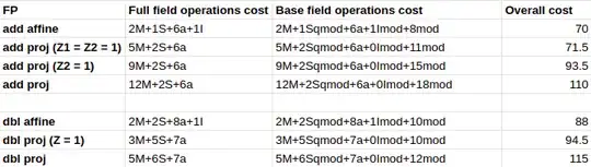

$F_{p}$:
As you can see, there's no meaningful difference that benefits the proyective coordinates. If anything, it's the other way around!

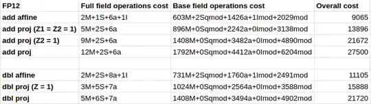

$F_{p^{12}}$:
In the case of the full field tower, the situation is much worse for the projective coordinates, taking anywhere between 1.5x and 3x the time to complete.
