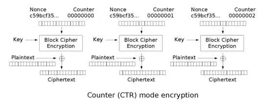

First let's include a picture of CTR mode:
Public domain by White Timberwolf & Gwenda

Yes. Assuming that the key is kept secret those can be shared with an adversary. The idea is that no information about the block that is part of the key stream can be retrieved by the adversary. A block cipher is a random permutation of the input block, in this case of the counter. That means that the output of the block cipher will be randomized even if the input is known. The block of key stream is the data that is XOR-ed with the plaintext block using the $\oplus$ operation in the picture that explains CTR mode.
