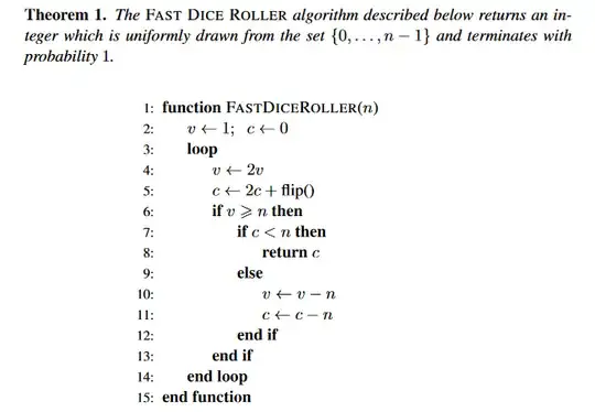

Posting this as an answer because nobody else cited this paper yet. In https://arxiv.org/pdf/1304.1916.pdf (Optimal Discrete Uniform Generation from Coin Flips, and Applications by Jérémie Lumbroso) we can read:
This article introduces an algorithm to draw random discrete uniform variables within a given range of size n from a source of random bits.
Below is the main algorithm reproduced.
fast dice roller
