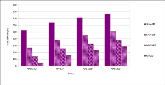

This then allows setting the input/output ratio to choose an output bias $\epsilon$. I use $\epsilon = 2^{-128}$ with SHA-512 because I can. Other ratios for interest are:-
