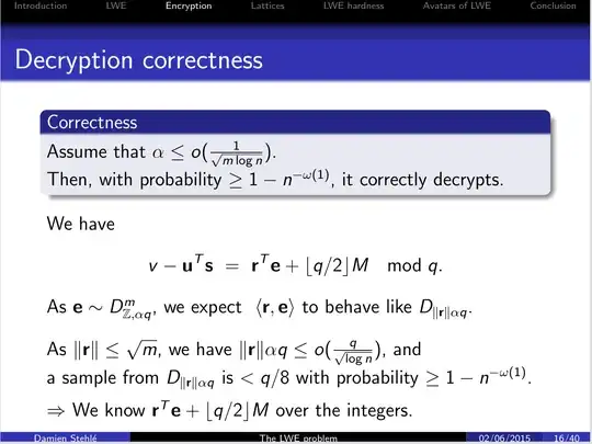

For LWE decryption, Someone told me that If we can bound r⋅e by q/4 then we can retrieve M by checking if this is closer to 0 or q/2
However, how to use tail estimation to derive the relationship between upper limit bound of standard deviation (α) and q/4 ?
Note: There is also upper bound value of sqrt(M) for r, which I am also quite confused with.

Now, I'll briefly describe how to instantiate #2 for your particular setting. First, note that $\vec r \sim U(\{0,1\}^m)$. It follows that $\lVert \vec r\rVert_2 = \sqrt{\sum_{i\in[m]} \vec r_i^2} \leq \sqrt{\sum_{i\in[m]} 1^2} \leq \sqrt{m}$, the bound you were confused about.
Now, to compute the distribution of $\langle \vec e, \vec r\rangle$, we need to compute the sub-gaussian parameter of $\langle \vec e,\vec r\rangle$. If $\vec e$ has sub-gaussian parameter $s$, then (Claim 2.4) the coordinate-wise multiplication $\vec r\odot \vec e = (\vec r_1\vec e_1,\dots, \vec r_m\vec e_m)$ has sub-gaussian parameter $\lVert \vec r\rVert_\infty s \leq s$. Then the problem reduces to bounding $\langle\vec r\odot \vec e, (1,1,\dots,1)\rangle$, where $\vec r\odot\vec e$ is a random vector of known sub-gaussian parameter. This can be done using results in the HDP book. In particular, sub-gaussian vectors have sub-gaussian marginals (see chapter 3), so one can view $\langle \vec r\odot \vec e, (1,1,\dots,1)\rangle$ as a distribution on $\mathbb{R}$ of known sub-gaussian parameter, and then apply what the HDP book calls the "General Hoeffding's inequality" (it also goes by the general name of a chernoff bound). This leads to the conclusion (for any $t > 0$, for a universal constant $c$)
$$\Pr[\langle \vec r\odot \vec e, (1,1,\dots,1)\rangle > \mathbb{E}[\langle \vec r\odot \vec e, (1,1,\dots,1)\rangle] + t] \leq 2\exp(-ct^2 / s^2).$$
You should definitely check this formula isntead of blindly applying it (in particular, one issue I have with the HDP book is the presence of (unnamed) universal constants (such as $c$). These can be explicitly computed (and need to be in practice), and other sources often do this.
Anyway, after appealing to the (general) Chernoff bound, one determines an acceptable failure probability (say $2\exp(-ct^2/s^2) = 2^{-m}\implies t^2 = (m+1)s^2\ln(2)/c$) to determine how large $t$ must be, then sets the threshold $q/4 > t + \mathbb{E}[\langle \vec r\odot \vec e, (1,1,\dots,1)\rangle]$ for the threshold one just computed.
There are of course details to fill in here (explicitly computing $\mathbb{E}[\langle \vec r\odot \vec e, (1,1,\dots,1)\rangle]$, finding a form of a chernoff bound that does not have an inexplicit universal constant, and making sure that the computation of the (scalar) sub-gaussian parameter from the (vector) sub-gaussian parameter was correct). But this is a general sketch of how the argument goes.
You might notice it slightly differs from the argument you have linked --- that argument uses the $\lVert \vec r\rVert_2$ rather than $\lVert \vec r\rVert_\infty$. In general, there are a large number of (roughly equivalent) ways of bounding these quantities using "Chernoff bounds". In fact, there really isn't a single "Chernoff bound" in the first place (instead there are many, depending on how one approximates a certain function which shows up in the "canonical" bound). This is to say that slight differences in how the precise probabilistic argument proceeds are fairly typical, but one always proceeds via one of the 3 techniques I sketched arguments for above.
