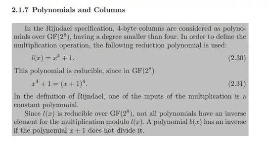

You can see an algebraists view of AES at in a document written by H. W. Lenstra.
There is also the more detailed The Design of Rijndael document by the designers at Daemen's homepage. Specifically on page 16, there is:
this
Maybe this is what is getting you confused, since multiple bytes are viewed as polynomials over $GF(2^8)$ for this part of the representation.
