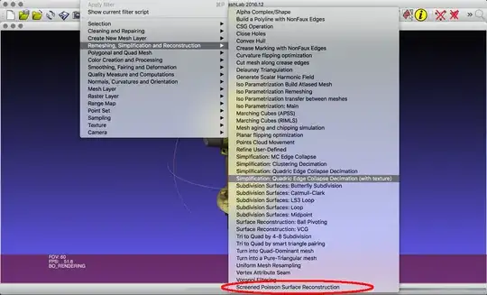

When I reached the step: "Remeshing, Simplification and Reconstruction I discovered that "Surface Reconstruction: Poisson" does not appear in my Meshlab (V2016.12).

Same menu, different location in the sub-menu (at the bottom):
Screened Poisson Surface Reconstruction
As T.M. states in their comment, see Poisson mesh reconstruction on StackOverflow:
MeshLab 2016 now uses the new version of the Poisson merging, and the filter is called:
it is in the same submenu, on the bottom. The relevant parameter (octree depth) is called Reconstruction Depth. It is now possible to merge multiple layers at once, without flattening them beforehand (as before). If source layer(s) have color, the result will be colored too. If you want to have the same result of the old version, put 0 in the "interpolation weight" parameter
