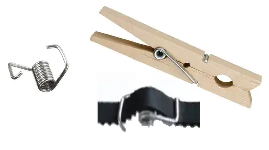

People are using this
Clothpin springs repurposed into a makeshift belt tensioner
to tighten the belt but I would totally agree with @Tom - there is no need to use such devices or gauges and your problem lies in stepsticks current.

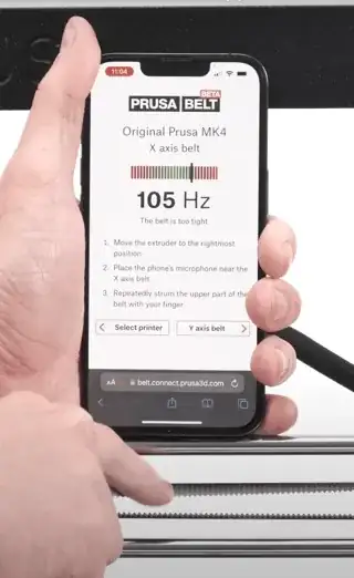

Added for reference. To my understanding, especially if you run multiple identical printers, having the same belt tension on all of them is essential to getting accurate and consistent results. The effects of overly loose or overly tight belts have been demonstrated in a YouTube video by CHEP.
As mentioned in the comments above, a frequency analyser on a smartphone can be used, a web-based analyser is available at belt.connect.prusa3d.com. Additionally, the article Adjusting belt tension (MK3/MK3S/MK3S+/MK4) explains the concepts and steps that can be taken for belt tensioning.
Photo of the web-based Prusa Belt (Beta) frequency analyser on a smartphone

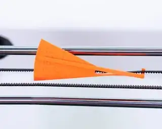

Also, a simple belt tension measurement tool called Tension Meter for the GT2 belts of i3 MK3S+ or Prusa MINI+ that can easily be printed has been published by Prusament.
There is a similar printable model called True Open source tension meter for GT2 belts by ChipCE.
