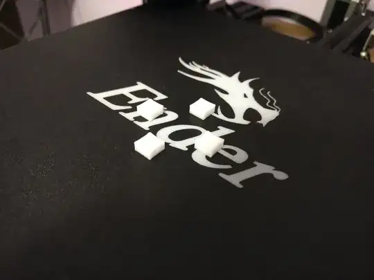

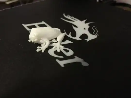

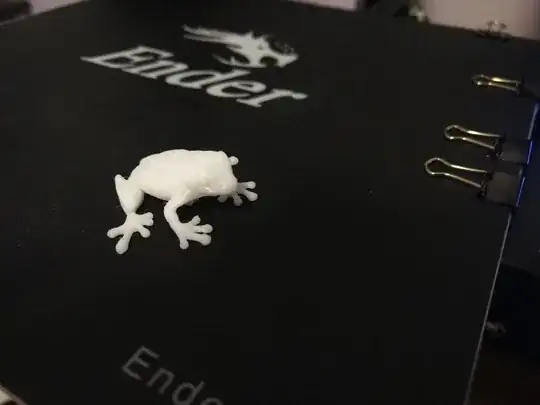

And the results:
test print with no stringing
frog with support, no stringing
frog with support removed

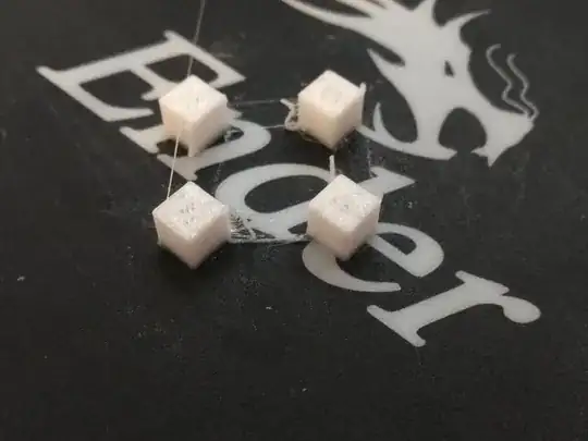

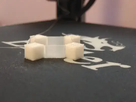

The right path seems to be enabling retraction, but tuning the retraction and print speed settings. I started out by dropping all speed settings to 30. With retraction disabled, this turned the stringing into solid walls between paths, with only a tiny gap at the very start of the wall, right after the extruder stopped:
This suggested that the sudden drop in pressure at the nozzle is cutting off the string momentarily. Back to that thought in a bit.
Independently of the pressure thought, I decided to turn retraction back on, but with really slow retraction speed. This helped a lot, but probably not the way I expected; I think what it did was give the nozzle time to ooze at the point where retraction happens, rather than in the travel path. I also turned off infill_before_walls, so that the retraction and potential oozing would happen in the infill region rather than walls, and increased the travel speed way up to 200 to take best advantage of the moment where oozing is interrupted.
At this point, I'm getting almost-acceptable results with retraction_retract_speed set to 5 (vs default 25), default retraction amount, and speed_travel of 200:
