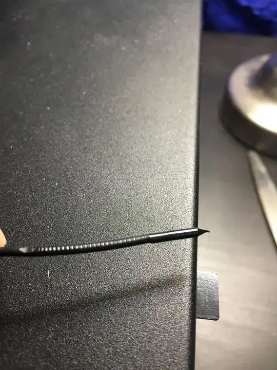

So here is my problem, after about 200-300 mm of extrusion, the PLA stops coming through the nozzle. When I pull the PLA out it looks like this. There are teeth marks going up the PLA and end with a small divot. The head of the PLA is slightly thicker than the rest of the PLA; approximately 1.9 mm.
Filament shape after taken out of hotend
I first noticed this when I thought that only the bottom layer was being printed. I moved to printing a small bullet and I got about halfway through the print before it stopped extruding.
Next I raised the Z position to about 100 mm to give me some room to work and I manually moved the PLA through the extruder with the dial. No problems until I hit the 200 mm mark or so. I've done this test 4 times now and failed at the approximate locations: 208 mm, 280 mm, 250 mm, and 325 mm.

Looking at the tread pattern on the filament, I think it's getting stuck. Note that the teeth marks get closer together as you go up the fillament, and the last one is a big divot, that looks like the gear trying to grab at it, and being unable to move it.
Are you seeing any drops in nozzle temp? I had a cooling fan kick in and drop temps low enough to prevent extrusion before.
Edit
From the discussion in the notes, heat creep was identified as a possible culprit, and seems most likely.
