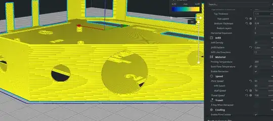

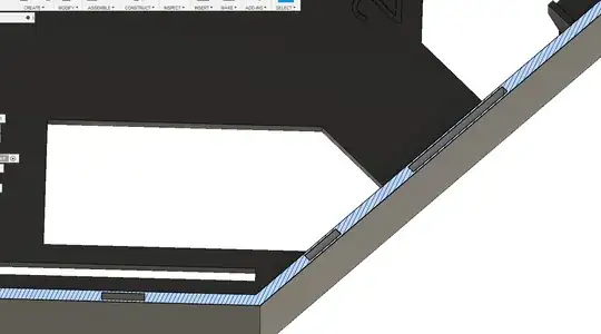

I made a model for my 3D clock. Model has few vertical holes so I made one layer thick bridge for every hole. In Fusion 360 everything looks fine, but CURA (version 3.6.0) doesn't want to print those Bridges. Why?
The Full Wall is 1.68mm thick(in Fusion), infill is 20%, wall line count is 1, layer height is 0.28mm, the support-bridges are designed to be this thick too.
I'm not sure will be material stable above holes without Bridges.
Bridges in Fusion 360

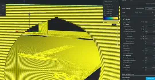

Model in CURA 3.6.0
Hole at close

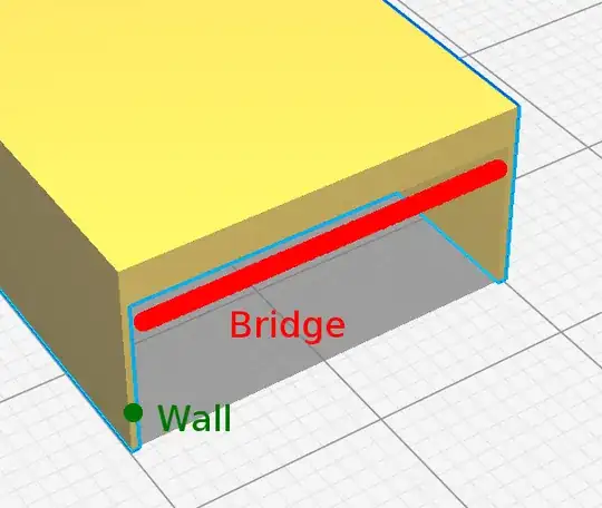

  • A Bridge is printing horizontal layers that connect to walls at the sides but otherwise not connected to the printbed or print.
A simple bridge

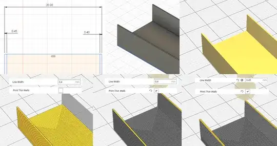

Ultimaker Cura does ignore too thin walls
Your walls are 0.28 mm thick and your nozzle is most likely 0.4 mm thick. That can't be printed at all, in fact, you are way too thin to be printed: a printer should never print any object that is thinner than its nozzle as that is a perfect way to generate clogs.
Atop that, slicers ignore also what is thinner or exactly as thin as the line width. If the line width is 0.4 mm, and the wall is 0.4 mm, it gets ignored. If the wall is 0.45 mm, it is not. This can be remedied by setting the option print thin walls, but you still need to have one line nozzle-diameter as minimum line width - actually it is common to go about 10% larger for better extrusion.
Solution
Strengthen the walls to one line width (usually 0.4 mm) in your CAD-design and activate print thin walls under Shell.
A design with too thin walls
