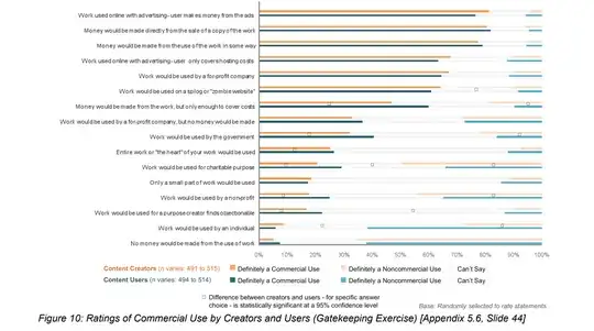

Gatekeeping Factorsp.54
Figure 10 from the report

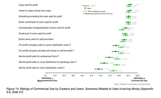

Figure 13 from the report
On the question of making money for cost recovery, creators think covering distribution costs only is slightly more commercial than covering operating costs, or raising money for an endowment fund. Users tend to agree, but overall see these uses as rather more commercial than creators.p.60
Conclusion
Contakt the maker that designed the part what is OK with them. But be warned: The broad idea the report gives is that around 3 of 4 of the makers and 4 of 5 users deem a "For Profit-Company selling [a thing] to cover distribution costs" as breaking the NC clause, as they deem it commercial use
