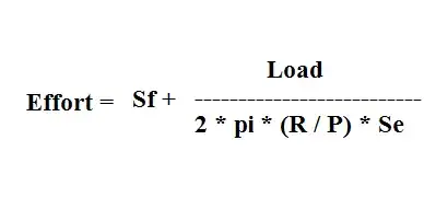

Equation
where,
  • p = pitch of the screw
  • Se = screw efficiency = Standard lead screw will be between 20% (.2) and 40% (.4)
  • Sf = static force. This is the force that is needed to start the movement. The number may be eliminated, but it is good to use a number in the 5 N to 20 N range.
  • Load = the expected load that the effort will need to carry (i.e., the router and the included axis assembly that the motor will need to lift)
  • R = radius of the lead screw
Based on this equation with following data
  • Load: 5 Kg = ~25 N
  • Thread rod specs;
    • Pitch : 1.25 mm = 0.0492126
    • Dia : 8 mm = 0.314961 inch
  • Motor :
Calculated Effort = 6.22 N = 1.4 lbf = 22.4 ounce
Radius = 8 mm = 0.315 inch (using Pitch conversion table)
So torque = 22.4 * 0.315 = 7.056 oz-in = 0.0498 Nm
As per data sheet Motor can provide an Axial force of 10 N. I'm using two of such motors, so this motor is enough

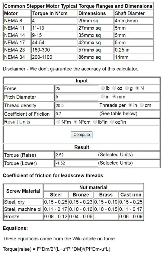

However, based on this calculator, Lead Screw Torque and Force Calculator, with following information:
Torque required to raise in 0.0252 Nm.
  • Which should be used for calculations?
  • How to find the running torque of stepper motor?
  • I know it will be less that Holding torque, but what percentage?
Nema 17 that I've given Holding torque is 5.5 Kgcm or 0.55 Nm. My second calculation gives the calculated torque to lift is 0.0252 Nm.

First equation
Your first equation, for effort, is
$$F_{effort} = S_f+\frac{Load}{2*\pi*\left(\frac{R}{P}\right)*S_e}$$
where,
  • Starting Force, from linked article, worst case scenario, $S_f = 20$ N
  • Radius $R=4$ mm$=0.004$ m
  • Pitch $P=1.25$ mm$=0.0125$ m, and
  • Screw Efficiency, from linked article, worst case scenario 20 %, $S_e=20=0.2$
So filling in the numbers, for 25 N:
$$effort = 20+\frac{25}{2*\pi*\left(\frac{0.004}{0.00125}\right)*0.2}$$ $$effort = 26.22$$
It is worth noting that this running torque only comes to 6.22 N, much smaller than the worse case value of the starting force, of 20 N:
$$\frac{25}{2*\pi*\left(\frac{0.004}{0.00125}\right)*0.2}$$ $$ = 6.22$$
and plugging in the numbers, for 50 N:
$$effort = 20+\frac{50}{2*\pi*\left(\frac{0.004}{0.00125}\right)*0.2}$$ $$effort = 32.44$$
Again, it is worth noting that this running torque only comes to 12.44 N, much smaller than the worse case value of the starting force, of 20 N:
$$\frac{50}{2*\pi*\left(\frac{0.004}{0.00125}\right)*0.2}$$ $$ = 12.44$$
It should be noted that these values are for a force, in N, not torque, in N•m, and I can't see on the datasheet were you obtained an Axial force of 10 N. To convert these to a torque, you must multiply by the radius of the M8 x 1.25 spindle - M8 is 8 mm, therefore the radius is 4 mm, which is 0.004 m:
$$T_{raise} = F_{effort} \times 0.004$$
Thus reducing the values for the Torque (derived from the effort) even further, by a couple of orders of magnitude, to 0.104 and 0.12976 N•m, for loads of 25 N and 50 N respectively.
So, the estimated value of worst case starting force would appear to be the dominant factor in selecting the stepper motor.
Regardless of all this, if, as you say, that the holding torque, $T_H$, is higher than the running torque, $T_{raise}$, then the holding torque would be the deciding factor in selecting a stepper and the running torque can be discounted.
It is unclear whether the equation that you found is the appropriate equation for calculating the holding torque. This equation appears to be for moving the load, whereas you need it for merely holding the load. For completeness both the holding and lowering torque values should be calculated.
Second equation
Your second equation apparently from Wikipedia - Force, via Lead Screw Torque and Force Calculator,
$$Torque_{raise} = F*D_m/2*\frac{L+\mu*\pi*D_m}{\pi*D_m-\mu*L}$$
where,
  • Force, $F$
  • Diameter, $D_m$
  • Pitch distance of square thread, $L=\frac{1}{D_{Thread}}$, where $D_{Thread}$ is the thread density given in the table.
  • Coefficient of friction, $\mu$
Whilst I can not see that equation on Wikipedia's Force page, I did manage to find the equation for raising, and the equation for lowering, on the Wikipedia page for Leadscrews - Mechanics1:
$$T_R = \frac{Fd_m}{2}\left(\frac{l+\pi\mu{d_m}}{\pi{d_m}-\mu{l}}\right)$$
and
$$T_L = \frac{Fd_m}{2}\left(\frac{\pi\mu{d_m}-l}{\pi{d_m}+\mu{l}}\right)$$
Plugging in the numbers for 50 N of load:
$$T_R = \frac{50\times0.007375}{2}\left(\frac{0.00125+\pi\times 0.25\times0.007375}{\pi\times0.007375-0.25\times0.00125}\right)$$ $$T_R = 0.1848 \times 0.308$$ $$T_R = 0.0568$$
$$T_L = \frac{50\times0.007375}{2}\left(\frac{\pi\times 0.25\times0.007375- 0.00125}{\pi\times0.007375+0.25\times0.00125}\right)$$ $$T_L = 0.1848 \times 0.193$$ $$T_L = 0.0357$$
NOTE: As the link to the calculator states, there are two different torques - one to raise, $T_R$, and one to lower, $T_L$. As the lowering torque, $T_L$, is less than the raising torque, $T_R$, then it isn't really necessary to calculate it, or consider it when selecting the stepper, as the raising torque is the dominant factor.
Again, if, as you say, that the holding torque, $T_H$, is higher than the running torque i.e. $T_R$, then the holding torque would be the deciding factor in selecting a stepper and the running toque can be discounted.
