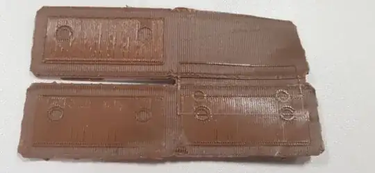

UPDATE: Image has been attached of the failed part, excuse the colour, I use it for my test prints. This is orientation it printed on the bed. First 3 blocks printed fine, 4th one jumped It printed in the following order 1. top-left, 2. bottom left, 3. bottom right, 4. top right.
Failed 3D print part

Looking closely at the image, you will see that the infill of the first layer does not touch the outer lines. This could be a hint that your belts are not tight enough (mechanical issue). Too loose belts cause the stepper driving pulley to skip. Also check the pulley whether it is securely fastened so that the pulley is not slipping when subjected to an increased torque. The nozzle most probably hits the raft (ABS? as it curls up and detaches, you see some irregularities on the left of the bottom right product in your image). Do note that too tight belts are also not wanted as they stress the stepper by an increased torque load. If the issue is electronically related, you could thick of increasing the torque by increasing the current through the stepper (and driver). Too much current will overheat the stepper driver though, so make sure that these do not exceed their rated maximum and properly cool the stepper drivers.

I'm guessing that the bed in the offending corner is farther away and your raft is curling and lifting off the bed in that corner, and your nozzle it hitting it. Try releveling your bed, paying particular close attention to that corner. In addition, work on bed adhesion in general. Clean the bed, make sure fan is off on first layer, and go slow on first layer, and use proper bed temp for the material. You can also try glue stick.
