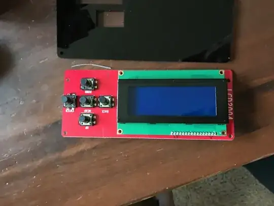

Screen Top

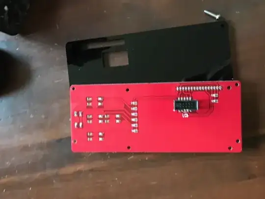

Screen bottom

This definitely sounds like a problem with your wiring if you have a genuine Anet A6, the genuine A6 comes with a 12864 full graphic display. For sure, you are missing 1 flat ribbon cable (see below). Maybe this is causing the LCD not to light up and the SD card not functioning. As the "fan 2" is working, the board is powered by the power supply (this fan is using the constant power feed of the supply of the board). What you are actually describing as a boot sequence is the actual boot sequence of a printer. Once you power the printer, the fan that is cooling the cold end of the extruder should start spinning and keep spinning while the part cooling fan usually spins up but then powers down to standstill. While this is happening, the LCD should come alive and show the boot screen and finally the printer menu. If your screen is not showing any light, this implies that your screen is either broken, not powered or wrongly connected.

2.Auto leveling A6-L work with LCD2004 screen, A6 work with LCD12864 screen
The second remark from the quote above suggests that there is a 2004 LCD version that is only used by the Anet A6-L version (probably because they need a free pin for the auto leveling sensor). Such a display only has a single connection socket and needs to be connected to a single socket on the Anet printer board (named "LCD", not "J3")

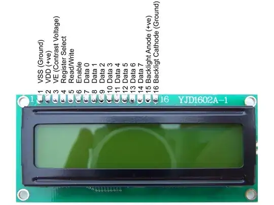

When the LCD does not light up, this could be caused by incorrect placement of the flat cable, be sure to use the correct socket on the printer board and take care of the orientation. Once you have checked this, and it does not work and you are in the possession of a multimeter, you could measure the voltage over the "VSS" and the "VDD" pin; also look into the voltage over the "VSS" and the "VE" (see pin layout below). If there is power, but no light, the LCD is probably defective. You could try to hook up a computer to the board using a USB cable and use a program like Pronterface to interface with the printer to see if it works at all, the display is not required for printing (e.i. if you can access the printer over USB).
Typical 2004 LCD pin layout

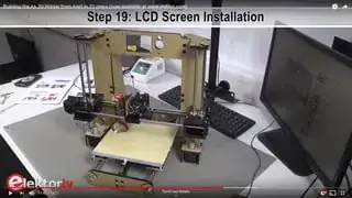

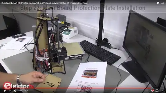

Please do note the the installation of the Anet A6 LCD display (see this movie and the screenshot from this video below) requires 2 flat ribbon cables to function properly.
LCD screen installation Anet A6
2 ribbon cables inserted in printer board
