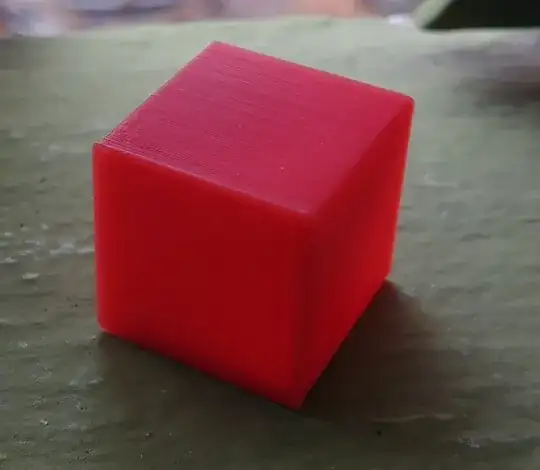

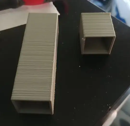

I'm 3D printing almost 2 years, and I expected to have better result after changing to complete smooth rods with new bearings.
I have a problem with my Z axis giving me inconsistent prints; I already replaced the leadscrews, E3D clone with Bowden tube, I decided to replace all smooth rods on all axis and also the bearings. After I replaced all this, my prints are still bad, also I'm very dissapointed with the results after the replacements. I have checked all I could think of; PID tuning, belts, ....) but I'm running out of ideas.
inconsistent print layer results
Printing settings:
  • print speed is 40mm/s,
  • retraction is 3mm at 30mm/s,
  • extruder 205°C for the first layer, then 200°C

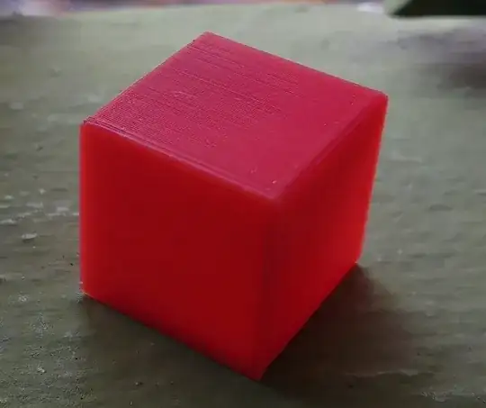

From the pictures can be seen that you have good lead screws as there is no cyclic anomaly/wobble present at the side. It appears as though the lines at the sides of the print are more or less random X/Y positional inaccurate.
These lines can be caused by various reasons. From what is read you tried to improve the mechanical system by upgrading the hardware. It could still be the case that there is still some backlash or play left in the system (e.g. I had once had too much tolerance on the holes of the linear shafts in the printed X-Z mounts causing similar problems). Vibration should be looked into also, e.g. do you have a binding bearing or a large mass on the printer that interacts with the carriage movement like a spool holder on top of your frame. Or maybe the micro-stepping does not work optimally, so check the stepper driver currents.
If it is no mechanical issue, it could be that you are facing inconsistent extrusion caused by variation in filament thickness or gear slipping or too much tension on the filament by friction in unspooling. Or else a hotend temperature variation. Maybe insulation on the hotend helps.

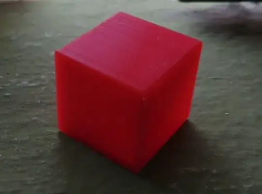

Yesterday I tried some improvements, first I replaced the Y belt pulley, and aligned the frame which I thought to be non-perpendicular and removed the spool holder (which was the culprit of my problem) Attached photo shows a print after these improvements. I have insulation on my hotend.
I think this is the quality I could expect from this cheap printer. Maybe I could reprint X axis gantry, but I'm a little tired of doing something on my printer.
Print after removing spool holder

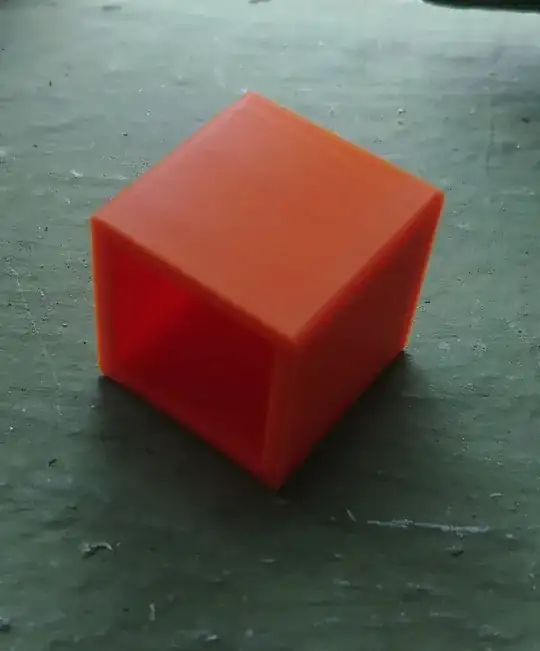

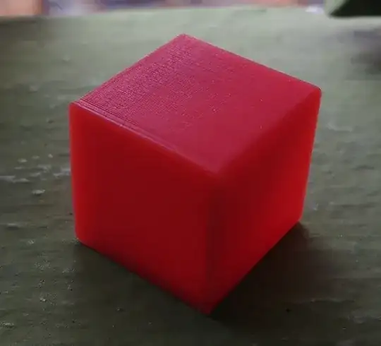

Update on my prints
I see some elephant foot, but i will fix this by lift nozzle a bit, but is there some more improvements (temp, retraction, z-hop, coasting, ....) ?
