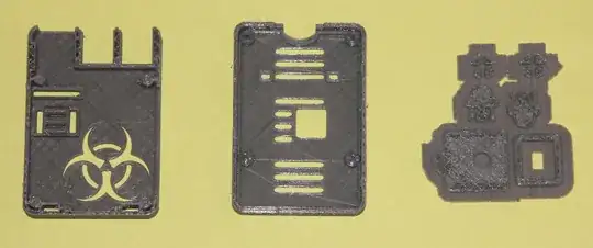

A Monoprice Maker Select V2, upgraded incrementally with a Micro Swiss all metal hot-end, machined lever, and D4 extruder gear, systematically fails to produce complete prints, as seen below:
Incomplete prints
The following observations can be made.
  • The nozzle clog appears at different heights/elapsed times, so it does not seem to be because of heat creep, which ought to take the same time to take effect, each time.
  • All the clogs so far have been easy to clear manually, once the hotend has been made accessible.
  • The filament (1.75 mm PLA) is quite new, has only been sitting on the spool at the top of the printer, seems regular in density, is not visibly damaged etc.
  • In the original configuration, before the upgrading, the printer worked fine for some months.
One possible explanation might be inconsistent temperature in the extruder, but the display does not show any great variation.
Any other theories? These latest prints were made at 210 °C.
The nozzle clogging was verified, each time, by trying to extrude using the printer controls; and then cleaned manually by taking off the "cold end" part, heating the extruder, and pressing the remaining filament out by hand.
Not so long ago the nozzle was cleaned with ethyl acetate and a needle, so I do not believe carbon build-up is the explanation.

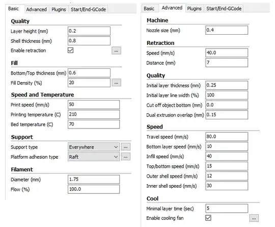

Cura settings:
Cura settings

The article describes what steps you could do to alleviate the problem. Of all the suggestions, "Minimize retraction", seems a possible candidate for you to look into considering the posted print settings. As this is a heat related problem it is advised to also increase your printing speeds, these are pretty low (30 mm/s for slow and 60 mm/s for normal printing) and also check the cooling of the "cold end" (the fan that cools the radiator fins). Also reduce the printing temperature, 210 °C is pretty high for PLA filament, personally I don't go over 200 °C (note that this depends on your filament, but most PLA brands can be printed in the 185 - 195 °C range).
You have a pretty large retraction specified. The Ultimaker default is 6.5 mm is considered to be large, but works perfectly for Ultimaker machines (read Bowden tube setup). In my Ultimaker 3E which uses all metal hotends, or, in my custom HyperCube Evolution, also Bowden, but with a lined hotend, 6.5 mm retraction works perfectly.
Please look into this answer and this answer. Both describe that the retraction performance is worse with all metal hotends. My experiences are exactly the same with metal hotends, at least the cheaper production ones (I tested cheap all metal hotends, but also ran into problems because of production and design errors, I have not tried the better quality heat breaks/throats yet).
Please lower the retraction setting considerably to see if it has an effect. The Monoprice Maker Select uses a direct drive. Direct drive extruders do not need a large retraction length setting. If the filament is hot in the throat (as there is no PTFE lining that in fact acts as an insulator), too large of a retraction may not be reversed when the filament cooles during the retraction.
