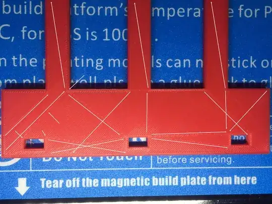

The problem is all the filament lines (travel lines, I think) that start at a sharp corner and go somewhere else. Most often, the lines go to another sharp corner but sometimes can intersect the middle of a side. See the image below for many examples. I have drawn white lines parallel to the unwanted filament lines in case they are hard to spot.
The unwanted lines also appear in the infill underneath the surface lines. They look like porous infill grid lines since they should probably not be there, and they do not get a full load of filament extrusion. You could easily say "Oh, they are the result of a "leaky" nozzle with poor retraction, but I think it's more complicated than that. I have done a full load of retraction tests and calibrations to optimize retraction lengths and speeds to minimize hairs.
Here is an image showing the problem:
Unwanted filament trails and infill lines parallel to white lines

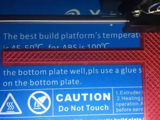

An image showing the trails in the infill

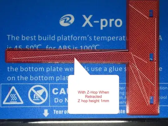

UPDATE: Here's an image with Zhop when retracted enabled at zhop height 1mm. This is an infill picture, so it cannot be directly compared to the surfaced original. But, the unwanted trails are all still there (although very thin). Maybe 2mm hop height will do it. I will run another test.
With Z-Hop When Retracted = enabled, hop height 1mm

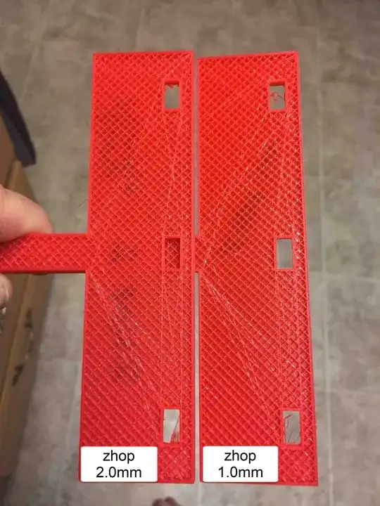

UPDATE:
I ran a second test with zhop 2.0mm, but without success. The problem was still there. (Retraction on, 8.5mm, min distance 0.8mm). Here is a comparison picture. I think the gcode is definitely telling my printer to do what it does, because the problem is not just a random leak. I think I'll try a different slicer in hopes that it generates different gcode.
Zhop comparision, 1.0mm on the right.

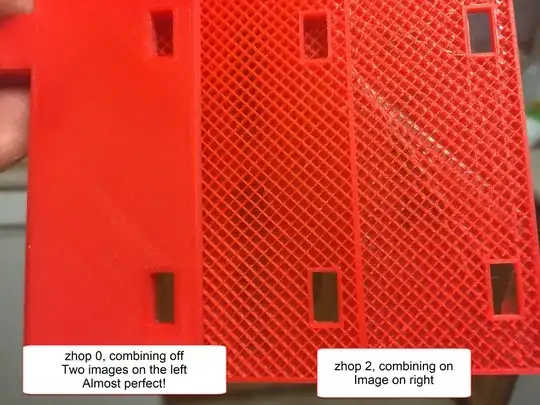

Here is an image of my new "perfect" prints thanks to Oscar's pointer on combing. The left two prints have combing off, zhop off. They are almost perfect, inside and out. The infill walls are generally solid and smooth (20% infill) and without the globs and gaps in the image on the right (with combing on).
As a closing note, I think the combing setting was probably also responsible for the problem of missing infill grids in the corner, as described in this question. The problem doesn't happen with combing off. My theory is that with combing on (as it was for that question), the oozing pulls filament out of the nozzle during the travel, so there's not enough filament at the destination to bite and bond to the corner. So, turning combing off solved 3 problems for me: the awful surface lines, the unwanted trails in the infill, and the missing infills in the corner. It also greatly improved the quality of the infill walls, too.
