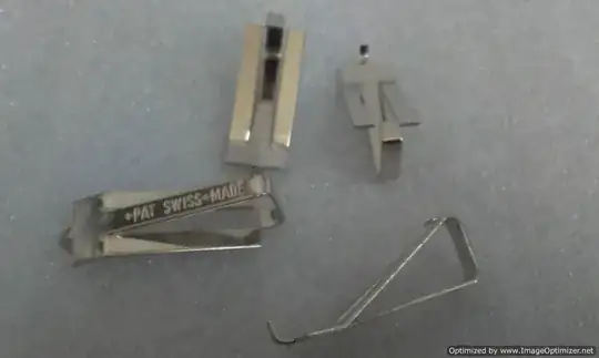

There are some clips similar to Trish's answer that aren't mounted but have a spring in them to apply pressure. Looks like they are called Swiss clips: Glass retaining clips – Swiss made:
Swiss clips

There is the "Swiss Made Glass Retaining Clip" Perplexed Dipole mentioned. Good idea, and instead of having to cut a notch into the aluminium bed, a simple, small hole would be sufficient. About the same price than a frameless picture frame but less construction work!

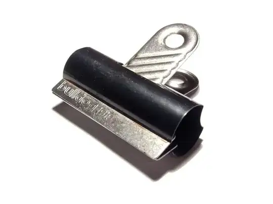

They might not work for every printer, but how about old fashioned bulldog clips:
Bulldog clips
Attached at both end in the y-axis, they will avoid your Z-axis rods and frame (attached in the direction of the x-axis I have noticed them catch against the Z-axis frame).
Like so (except the image below uses the foldback clips that (I assume that) you refer to):
The lever/handles aren't as long as those on foldback clips, and more sturdy too. Also, they have no curled edge that can catch the nozzle if mounted right.
You should obviously route any wiring/tubes away from the clips travel at the rear of the printer.

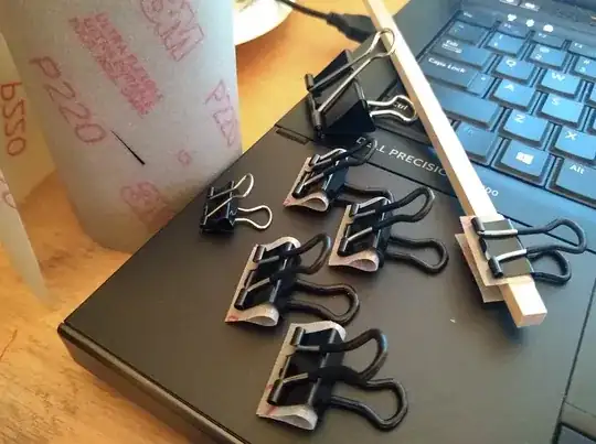

I went to OfficeMax and got some Small clips. They are bigger than the Micro/Mini clips that ship with the printer and seem to fit just right on a glass plate.
One of the Mini clips that shipped with the Ender 3 is shown to the left. The Small size that works best is obviously centered. The Medium in the back seem way too big.
For an added bonus, they sell this sandpaper with a rubber back and it really increases traction. An oversize chunk of that worked really well. But it's optional.
