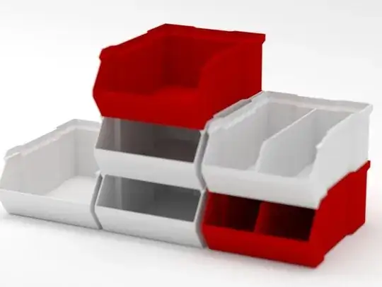

In your case (design of a container) I would consider what the purpose of the container is; e.g. how big is it, how much weight is it going to contain (e.g. heavy nuts and bolts, or left over filament pieces), is it stackable, etc. etc. etc.. As a final thought, note that you can play with the design as well, a straight box/container is less stiff than a box with some curved edges or stiffeners. An example of a stackable container is e.g. this:
Stackable container
The indents on the walls of this container give it more rigidity, these walls are in the range of 2 to 3 perimeters.
