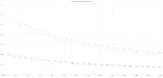

To show this better, a graph: This is the length of a filament spool in dependancy of the density. The values were calculated for the usual diameters with their closest neighbors rounded to 0.1 as absolute diameters and run over a broad range of densities commonly used in plastics - 0.7 g/cm³ to 2 g/cm³.
length of filament depending on diameter and density

The 110 meter figure is for 3.0 mm filament that actually is 3.0 mm in diameter. As you (correctly) note, most 3.0 mm filament is often actually closer to 2.85 mm. In that case, the correct figure is indeed around 125 meters. Note that this figure is for PLA filament (see e.g. my answer here). For ABS, being significantly less dense, a 1 kg spool would be around 155 meters.
