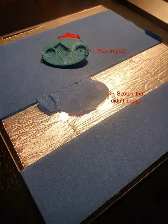

I would advice against it, or at least have some detection for when the object won't budge:
Print damaged by impact
Leaving a printer unattended needs special care too (fire alarm springs to mind but not only).

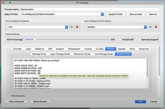

Another method - shake it off
Taken from Automatic 3D Print Removal using G-Code, by Make Anything
In order to shake the completed print from the bed, you can use an ending script, like so:
Screenshot of ending script
See the video at 2:45 for an explanation of the scripts, both starting and ending. Note that the starting script does not include a wipe (for purposes of a purge), as a brim is used, which acts as a purge.
The code is:
G1 X105 Y195 Z50 F3000; Move up and back
; Make some (alert) sounds M300 S3520 P200 ; A7 M300 S4698.63 P200 ; D8 M300 S5274.04 P200 ; E8 M300 S6271.93 P200 ; G8
G1 X105 Y195 Z1 F3000 ; Lower G1 X105 Y1 Z1 F2400 ; Remove print G1 X105 Y30 Z1 F8000 ; Shake it out G1 X105 Y1 Z1 F8000 ; Shake it out G1 X105 Y30 Z1 F8000 ; Shake it out
;M106 S0 ; Turn off fan ;M104 S0 ; Turn off extruder ;M140 S0 ; Turn off bed ;M84 ; Disable motors
The guy is using an Anycubic i3 Mega, but this technique should work with most other printers.
